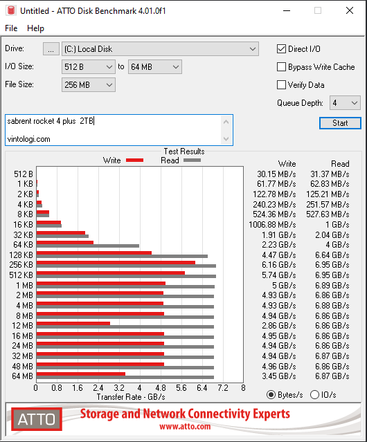

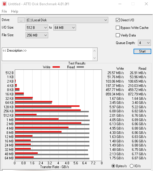

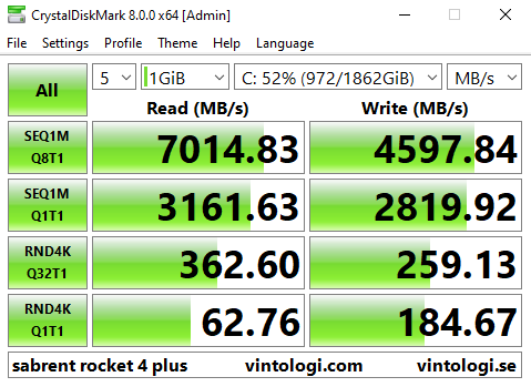

It turns out for best performance you need to use the "defragment and optimize drives" tool in windows 10. I also changed the power setting to "ultimate performance". Results still wasn't good

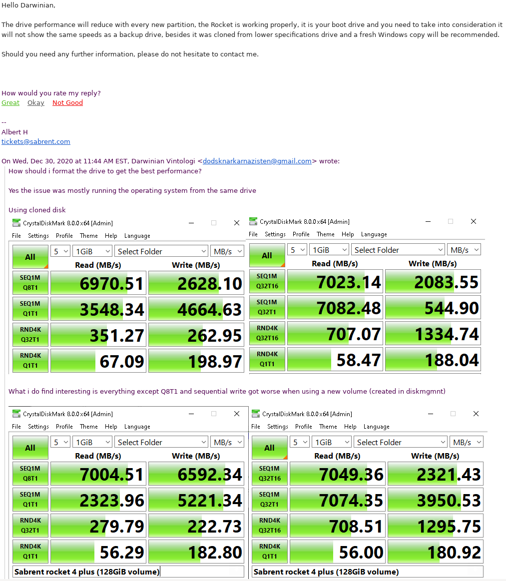

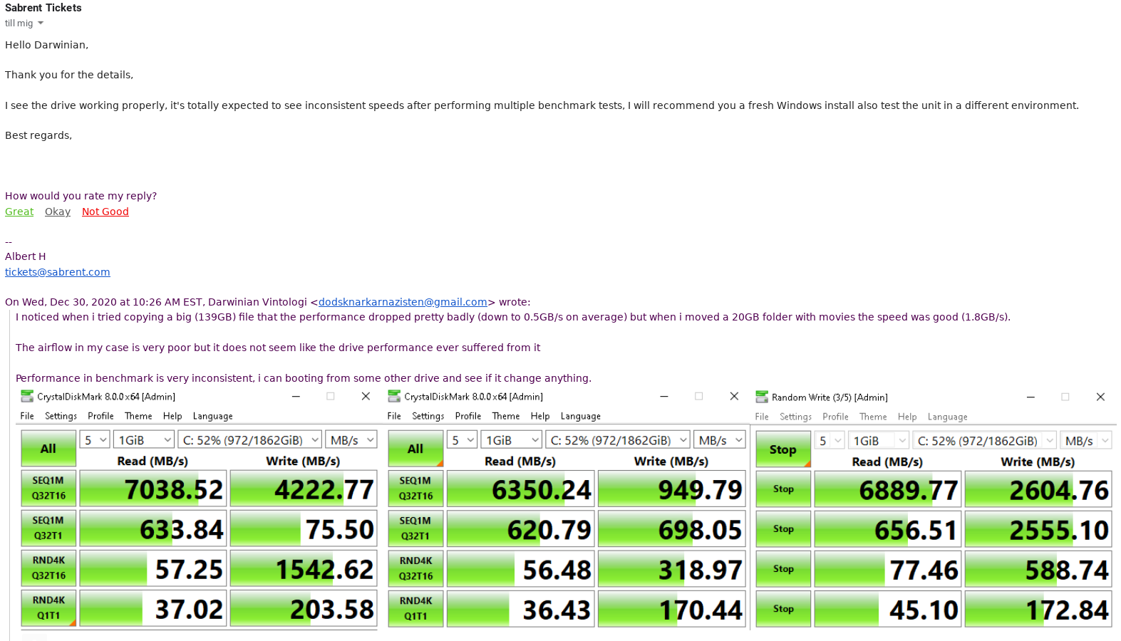

I ended up contacting sabrent costumer support but the individual basicially told me to make sure Trimp was enabled (it was already) and use "defragment and optimize drives" (which i had already done). Then he basically suggested making a clean install of windows 10, well they never mentioned you had to re-install windows to get the performance you paid for.

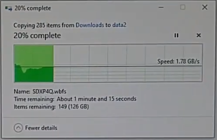

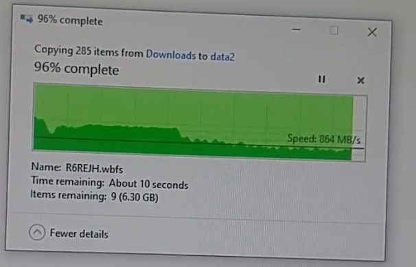

I also tried moving a 139GB folder and it took 2 minutes and 45 seconds with 900GiB of Free space.
To test this i booted via my old slow samsung 850 evo and ran tests from there

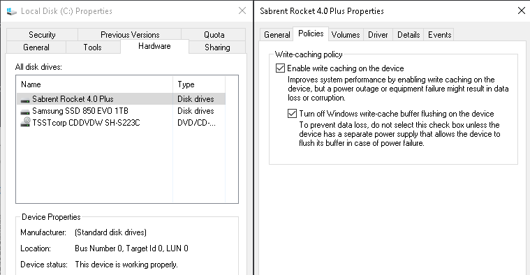

It turned out however that he was simply wrong, my SSD was not functioning properly and the issue was windows 10
https://superuser.com/questions/1214348/ssd-with-write-cache-buffer-flushing-turned-on-is-way-slower-in-as-ssd-but-not-c

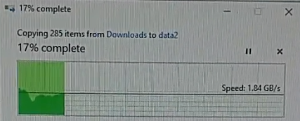

By checking the "Turn off windows write-cache buffer flushing" box you do however slighly increase the risk of data-loss in some scenarious but if you actually want to protect your data you should do an actual proper backup. This unfortunatily didn't completely fix the issue of inconsistent performance, the performance will still drop badly once the SLC cache is filled. To get to these settings search for "diskmgmnt" in the start manu and continue from there.
The time to copy 139GiB dropped down to 129 seconds (from 165 seconds)
Synthetic benchmark also improved significantly and results became less inconsistent

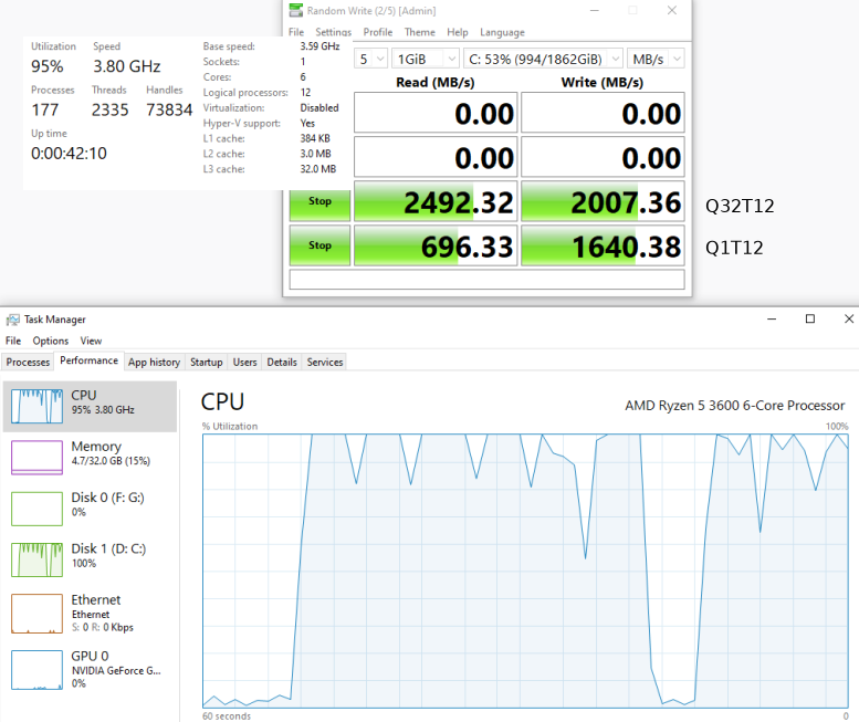

I noticed during testing that the randon write speed was CPU limited meaning you need a better CPU than r5 3600 to take full usage of the Rocket 4 plus 2TB

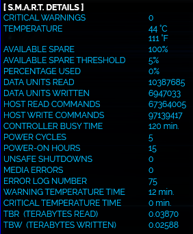

Temperature
Despite extensive usage it only reached the critical temperature (70 °C) 12 minutes.

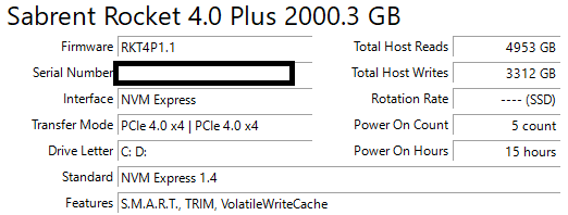

TBW in the picture above is the number of TeraBytes (not TiB) written divided by 140, when that number reaches 10 your warranty is gone, this is bad but the competition is even worse (not by much).

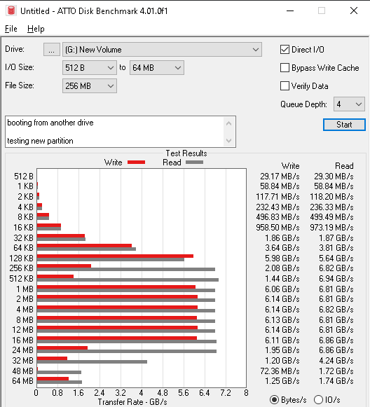

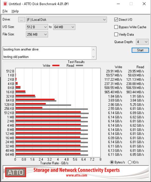

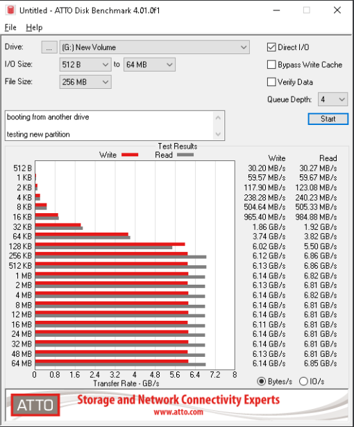

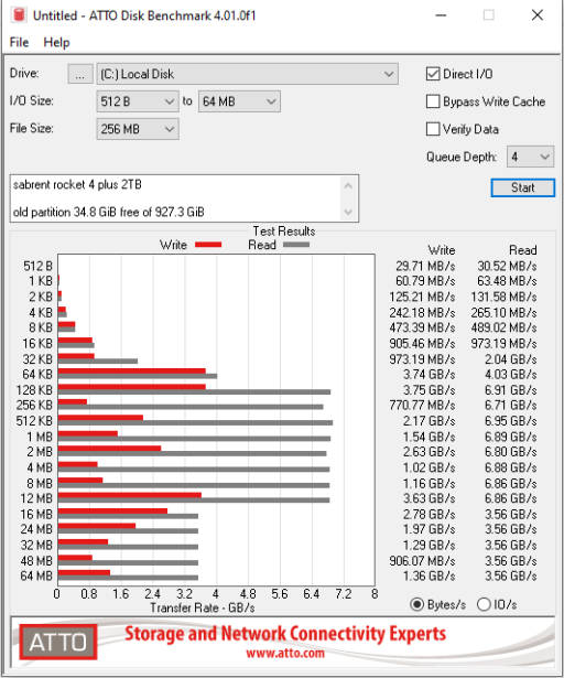

Old vs new partition

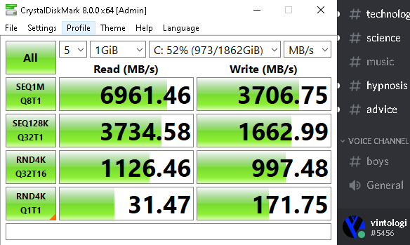

I did copy the partition via the xcopy command which took about 2 hours and 5 minutes. Then when i began to test the performance i found out that it didn't improve, instead results were a bit random and it was difficult to observe any pattern.
Its unclear why the performance of the old partition became good out of a sudden, there was just 34.8GiB free space.
The performance of the new partition became consistent after deleting a dublicated 20GiB folder
Same thing happened with the old partition, it just needed a little bit more free space

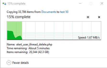

50 GiB folder copy test
Increasing the number of files further grinded the performance down to a halt, the SSD need large files to deliver good performance (up to 1.8 GiB/s).

This is not a good result.
I assume the disks where empty with no operating system running on them but they do not get into this in the review
Their 50GB dataset includes 31,227 files of various types, like pictures, PDFs, and videos.

Random read and write was CPU limited
I found this out by increasing the number of threads in CrystalDiskMark to 12 and running the random 4k Q32 test.

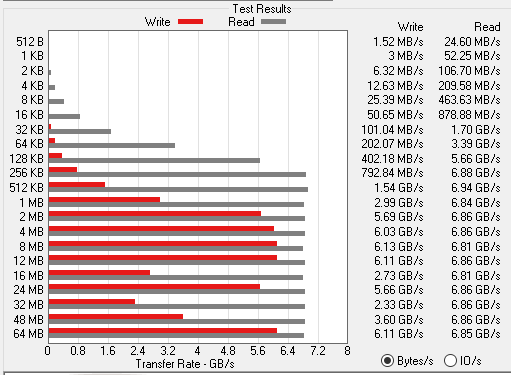

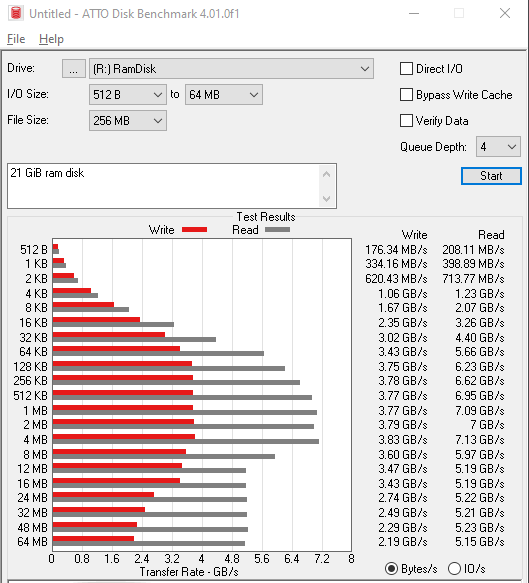

Sabrent rocket 4 plus vs Ram Disk
Benchmark like atto have "direct I/O" enabled by default that will bypass the operating system, this was disabled and the performance was compared to a ram disk, no difference.
There was some difference in file copy tests but i was unable to reach above 2.3 GiB/s even when only copying withing the ram disk.
This tells us that speeds above 2.3 GiB/s are essentially wasted and that the most important thing with an SSD is to deliver at least 2GIB/s consistently and unfortunatily sabrent rocket 4 plus fails to do that and therefore i will try to return it for a full refund.
It will take some time before we see programs take a decent usage of fast SSDs (direct storage, etc) but right now consistency is the most important factor.

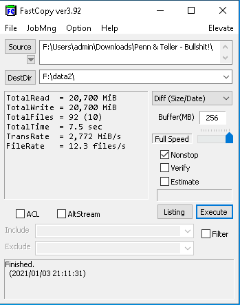

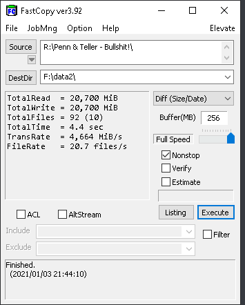

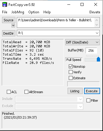

Tests using FastCopy
There is one windows programs that will offer significantly better speeds when copying files but unfortunatily its not particularly convenient to use, what we need is an program integrated in windows explorer or a stand-alone file manager.
The following test was done with FastCopy running the operating system from another drive, this is the moment of truth:
Read: 6495 MiB/s
Write: 4632 MiB/s
Mixed: 2756 MiB/s
https://download.cnet.com/FastCopy/3000-2248_4-10905019.html
Still despite these improvements there was still clear bottlenecks, copying a file within the ram disk gave an average of 3793 MiB/s which of course doesn't actually make any sense, it shouldn't be slower to copy a file within the ram disk than to copy a file from an NVME to a ram disk.

Despite my case having zero additional fans i never got to the point where the SSD throttled due to heat.
I later got told that it throttled at 70° C and that this is what it means by "warning temperature" i wrongly assumed it only throttled at "critical temperature" (110 °C), i did not properly measure the temperature and i was unable to find any more recent saved stats tnan the following

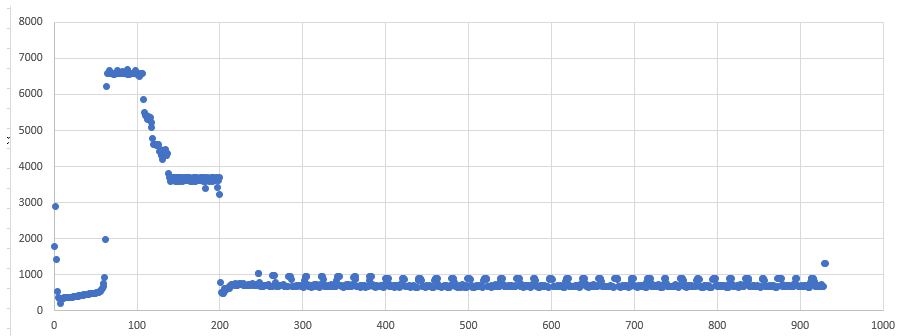

He concluded that the severe slowdowns is from termal throttling and not the drive running out of SLC cache.
TurboSSD wrote:
After doing about 200-250GB of writes with no airflow mine starts to degrade due to thermal constraints based on that hard 70C limit. Even in a 23C room with two 120mm fans aimed directly at it, I couldn’t saturate the cache without thermal throttling on the 2TB model.
Here you can see the thermal throttling - https://prnt.sc/wjt4qc
Ignore the first portion of the test where it's really slow and ramping up, this was a "dirty" (run only trim not secure erase). Once it ramps up to speed of 6.5-6.8GBps it can hold it for a few hundred GB, but once the reported temp hits 70C it will scale down performance to keep it there - you can see the performance scale down after 300GB of writes here until the cache fills to about 700GB.
For most workloads, it normally will not throttle. I need to test more GEN4 to gen 4 interaction once I update my system with a 5900X and newest X570 firmware, but most of the time my single transfers are like 1.5-2 GBps at most and in order to attain higher I have to break down transfers into like 2-3 in order to saturate bandwidth
