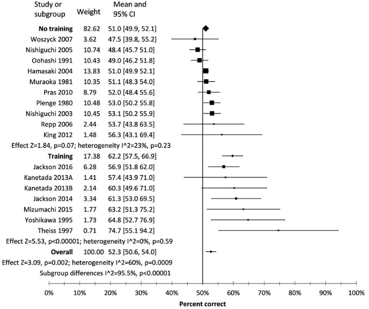

The ultrasonics high resolution audio often contain can however make an audible difference
I did my own test to confirm this (XY blind test)
Test0: i preferred 192 KS/s to 48 KS/s 9 of 10 times (p = 0.02148)
Test1: i preferred 44.1 KS/s to 96 KS/s 30 of 43 times (p = 0.01372)
Test1 was a piano track and while the 96 KS/s version did sound more like a piano i actually liked it better when the ultrasonic were cut off, this illustrates that often higher accuracy will not actually be more pleasing to listen to.
