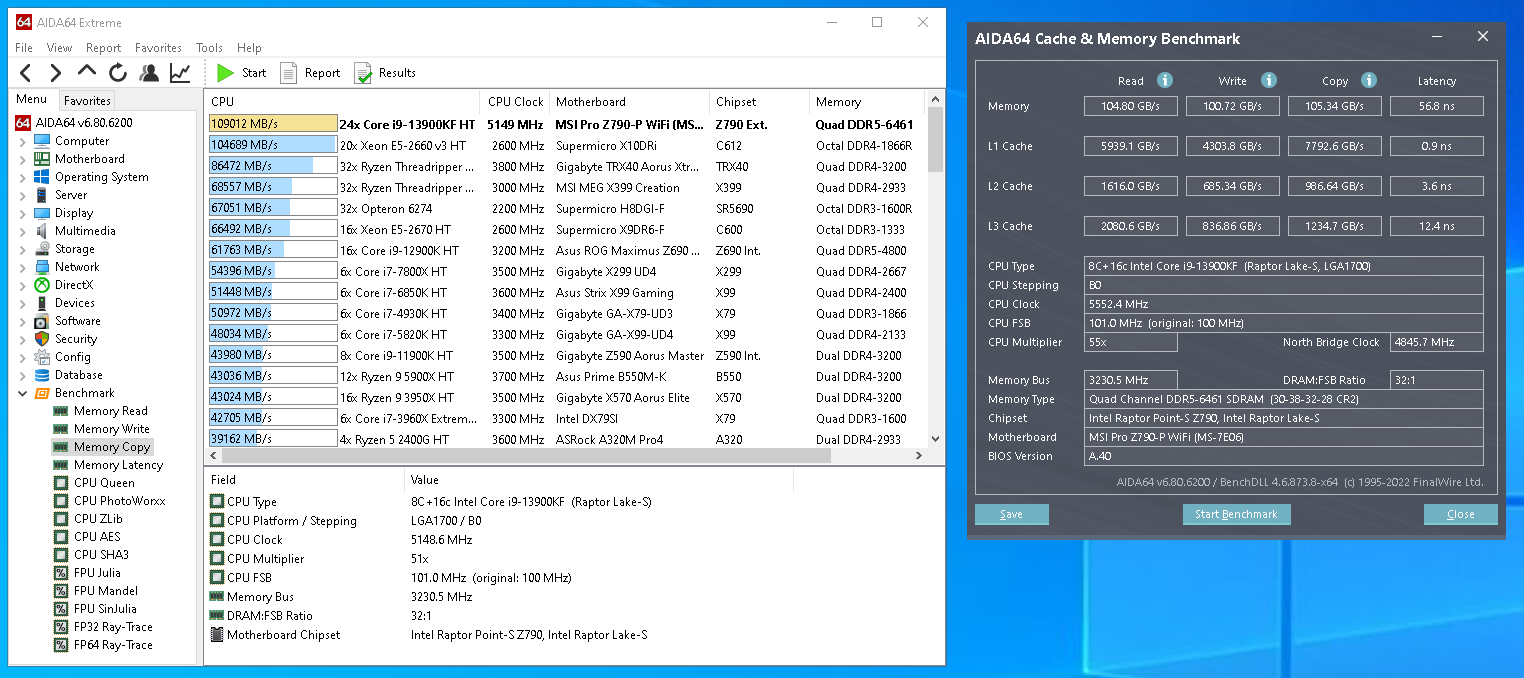

You can find out the max stable BLCK frequency for the CPU simply by lowering the DRAM multiplyer to a lower value to make sure any error you see is from the CPU and not due to you pushing the ram/imc too hard.
BLCK overclocking will sometimes produce very high aida64 read/write/copy figures due to a bug in the software. The actual perormance increase is no more than linear.
BLCK overclocking is very useful if you want to have a very stable overclock. You can simply tune it for maybe 102 BLCK and then when it seems to be fully stable make a second bios profile with the BLCK reduced slightly (such as 101.6), otherwise you might have a ram error occur once every 7 days or something like that.
